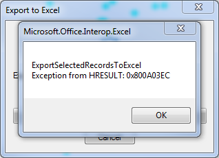

We use the ArcGIS for Water Utilities tools, and regularly make use of the Export to Excel button from the Water Utility Network Editing toolbar, however right after installing the new ArcGIS Maps for Office 4 the Export to Excel button doesn't work anymore - instead I get an error message
If I remove Maps for Office the Export to Excel works as normal.  Reinstall and I get the error again.  Nothing is exported.

ScottBall
Hey Mike - we haven't seen this before. Thanks for bringing it to our attention! I'll get it over to our support team and ask that they follow up to get this potential bug reproduced, logged, and sent to our dev team for a fix.

ScottBall
Thanks for the screenshots, very helpful. I've asked that an analyst follow up with you to figure out what's going on.
ScottBall
I just got notification that this issue has been reproduced internally and confirmed as a bug. It is being logged into our bug-tracking system and will be passed to our development team to be fixed. Thanks for reporting it!
