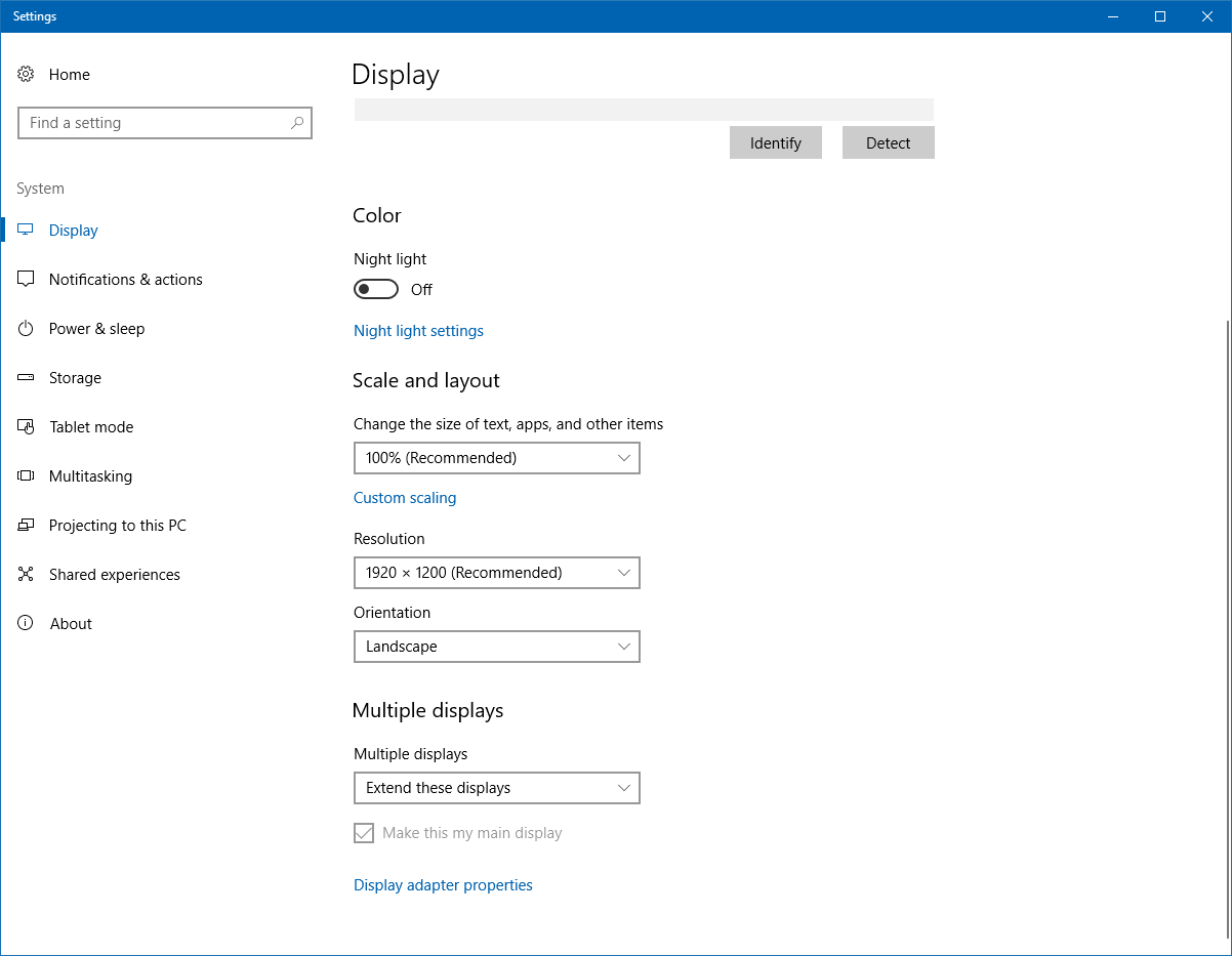

I thought this seemed like a reasonable answer, as Windows 10 can choose to do its own thing, sometimes. I checked the scaling of apps and windows. My settings are still at 100%. I guess the answer could still reside with some scaling bug, but on my computer, at least, it isn't resolved in the "Scale and Layout." There must be something in the registry freezing the window size.
