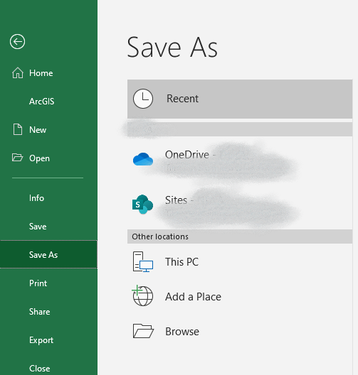

If user clicks "File" -->  "Save as", a dialog is opened which has options for the corporate network locations (OneDrive and Sharepoint Sites) as well as local.

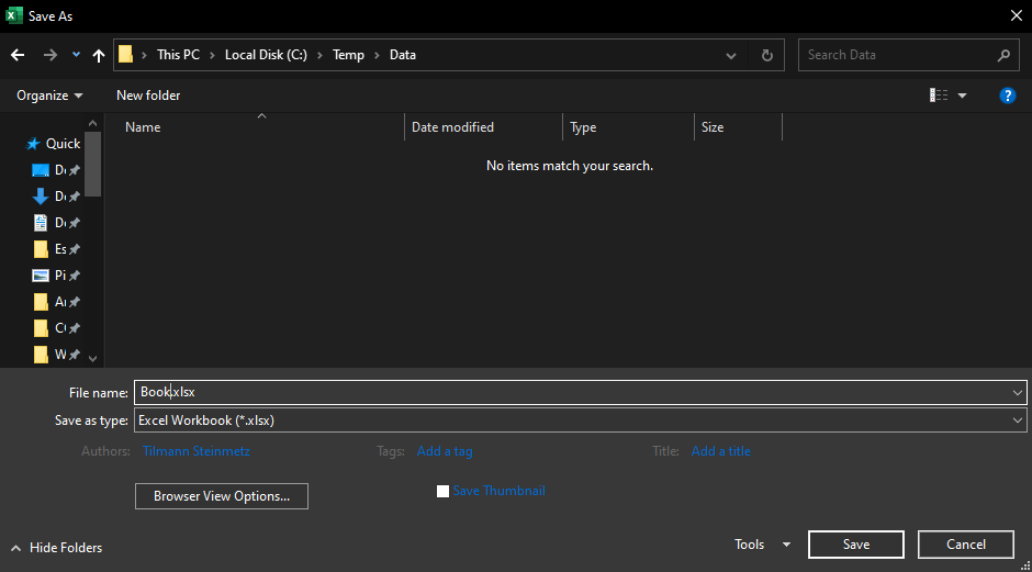

Saving in one of the network locations isn't working: the dialog opens and displays the network location, user navigates to correct folder and specifies a file name & clicks on "Save", then a second "Save As" dialog opens with the option to save to the local drive.
Select network location (e.g. a corporate Sharepoint Site) and navigate to folder:
Clicking on "Save" then brings up this dialog (which makes no sense at all as I've already specified a different location and file name for saving):
