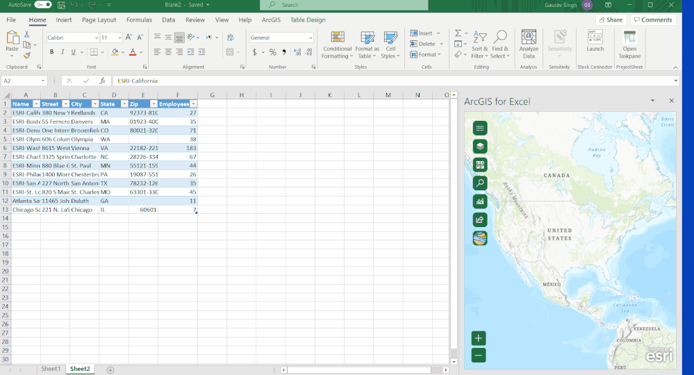

In the new ArcGIS for Excel Add-In tool I have added a list of address to the map and want to export the XY coordinates.  The features mention that if there are points the coordinates will be exported to a new sheet within the current excel file.  It does create the new sheet however the coordinates are not being exported as they were in ArcGIS for Office.  Is this a bug or am I doing something wrong?
Export data
You can export information about the selected features to a new worksheet in the current workbook. When exporting selected rows, they are saved in a new Excel worksheet (.xlsx) in the current workbook. Exporting to an .xlsx file creates an Excel table in a new worksheet that includes data for each feature selected on the map. If the selection contains point features, the table will include the coordinates for each feature. Polyline and polygon geometries are exported.

In the 'ArcGIS for Excel', the export tool wouldn't export the coordinates of the addresses into the new worksheet. The export tool exports the selected feature data on the map from your current excel file to a new sheet within the current excel file. If your original sheet contains coordinates, then you would see those coordinates in the exported new worksheet. We'll update the doc accordingly. Thanks for informing us about it.
Please use ArcGIS for Excel custom function, =ARCGIS.GETCOORDINATES to convert addresses to coordinates. Before you use the ArcGIS for Excel custom function, please ensure that you are Sign-in to ArcGIS for Excel.
Here are the steps to convert the addresses in your table to coordinates using ArcGIS for Excel custom function -
1) Sign in to 'ArcGIS for Excel' (A4Excel).
2) Convert the Excel table in your worksheet to Cell range (click Table Design tab in Excel Ribbon > Tools > Convert to range)
Columns created using the custom function couldn't be appended to the existing table. This is a limitation from Microsoft - https://support.microsoft.com/en-us/office/-spill-error-table-formula-8bfa1758-1be4-42f4-a974-c4d4bc...
Either write the formula out of the table or convert the table to a range.
3) Run =ARCGIS.GETCOORDINATES function to convert addresses in your worksheet to coordinates.
ArcGIS for Excel Team

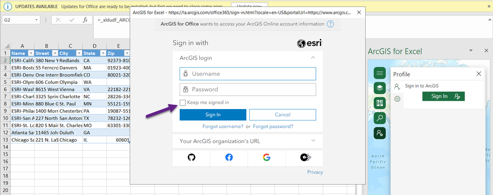

In the Sign-in window, during Signing, select the option 'Keep me signed in' - this will keep you signed in.

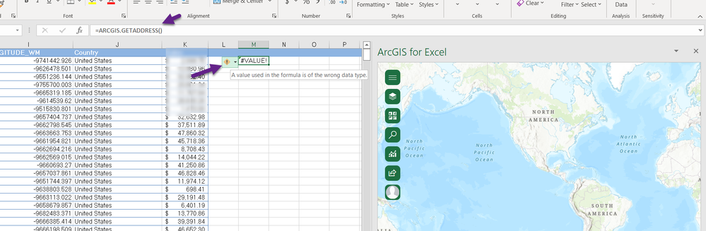

I tried to do the same function although I keep getting #value errors. Anyone have the same issue?
Gaurav-Singh
Please post the error message and ArcGIS Function's respective parameter values (dummy values would be fine) here. Here's how to obtain the error message - Select the Value error cell, and the exclamation mark Icon will display, hover over the exclamation mark, and an error message will display.
