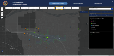

For example, the City of Redlands has commercial, residential, and industrial development in progress. There are new restaurants and opportunities, including a new train station and parking structure. Let’s plan to explore this in a bit.
The basis of the analysis – Commercial and residential locations
Resource: Redlands Development Projects

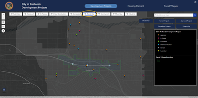

For example, map the City of Redlands' Commercial locations, and map the Residential locations to perform an area aggregation to determine the summary of available housing.
The basis of the analysis – North & South sides of Orange Ave., on the west side of Alabama St., to a new building, parking lot, and related site improvements on approximately one-half acre.

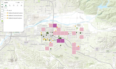

The setup:
 The results:
Our results indicate there are three 0.5 square mile areas within the city's project area for residential and commercial development that have a higher sum of places to live or move to.
