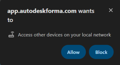

Note: you may be prompted with a Chrome browser notification saying "app.autodeskfor.com wants to access other devices on your local network". Select "Allow".
