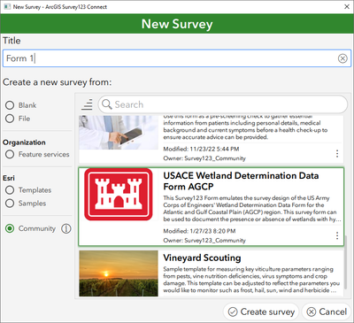

ThomasHamill
@madxwild and @CurtKleist, the USACE Wetland Determination Data Form (AGCP) is now available in the Community section of Survey123 Connect.  Here's the direct link to the survey item.
FWIW, here's the original thread associated with the effort.
