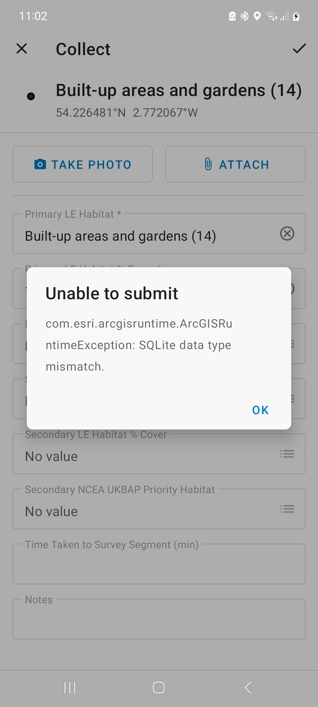

Hi,
I am unable to submit new points in offline areas in Field Maps, with the error message: "Unable to Submit com.esri.arcgisruntime.ArcGISRuntimeException: SQLite data type mismatch".
The layer being edited is a layer view, with editor tracking enabled, but the Creator and Editor fields excluded (CreationDate and EditDate still visible). Effecting several Android devices (version 13), using Field Maps version 23.1.1.

cmoore_ne
I drop the creator and editor fields to hide the names within the group that the view layer is shared to - by only hiding them in the pop-up, I think users of the group can still access those data fields from the layer's data tab in the group content?
