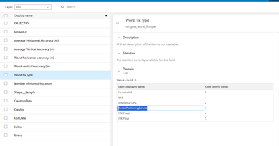

Hi @Dr_Jason_VanHorn I took a look at your data and I can reproduce the download failure. I think I see what is happening here as we might have uncovered a new BUG. Can you try deleting the value for "PrecisePositioningService" on the Field "Worst fix type" for both the Line and Polygon layers in your map? You can do this from the Data tab under Fields in the Layer Item Details. I have added a screenshot of what to delete as I do not have permission on your layer.

ColinLawrence
Note you will need to re-create your offline area after you have removed these values in order to pick up the new layer schema.
