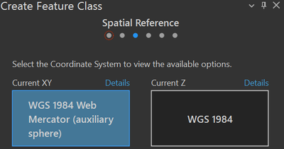

Hello,
I am working to set up ESRI Field Maps with ArcGIS Online hosted features to collect point location data using a Trimble Catalyst DA2 (with paired iOS devices). I don't have much experience setting up this type of workflow and am a bit confused when it comes to selecting the coordinate system for my AGOL hosted features. Is it a better practice to set the CS of the features to match the basemap (e.g., WGS 1984 for the default basemap)? Alternatively, would a better workflow be to set the coordinate system to match the receiver (NAD 1983 2011) or a local coordinate system (e.g., the appropriate NAD 1983 [2011] State Plane system)?
Any guidance here would be appreciated -- hoping to avoid an error at this early stage that will ultimately affect data collection accuracy.
Thanks, Alex

Alexander_Swain
Thanks Christopher!
Really appreciate the guidance and the extended explanation re: setting the layer CRS to match the basemap. If I understand your guidance correctly, I'll do the following:
  • For the feature layer, set the GCS as WGS1984 (WKID 4326) and project to web mercator (WKID 3857).
  • The basemap for the Field Maps app will be the ArcGIS default, which shares these respective GCS/PCS definitions.
  • Run the Add GPS Metadata Fields geoprocessing tool on the created feature layer.
  • Follow standard guidance to create the appropriate Profile (GNSS Coord == NAD83 2011; Map Coord Sys == WGS Web Mercator; select the appropriate datum transformation)
  • Enforce GPS accuracy (good recommendation)
One final related question: I have enabled Z Values when creating the feature layer. Is it appropriate in this case to set the vertical spatial reference to WGS84 as well?
In at least one of the tutorials I reviewed, this was left undefined and I haven't yet found definitive guidance on this topic.
Again, thanks for your insight here.
