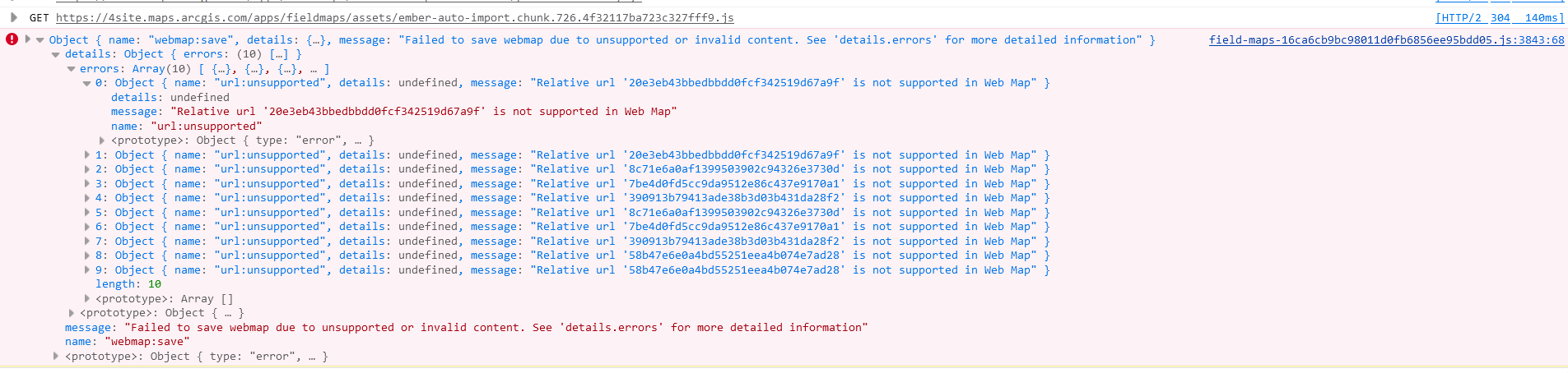

Then we create the forms in Field Maps in the web browser. There is a problem with the application because it prevents me to save a form after creation manually in the Field Maps
The saving forms is calling a save map method in the Field Maps web application as far as I infere for the console error message :

Are you the owner of the web map? If not, you could ask the owner to transfer ownership to you, but you'd probably have to refresh the browser tab for that change to take effect, so you'd still lose your changes.
If the permissions issue is with the map and not the layer, you could try saving the changes to the layer. This would update the form saved with the layer without saving the web map. Then when you add the layer to a new map, the form would be included. Expand the Save button to save to layer:
If you are the map owner and it's not a permissions issue, it might be interesting to see if you can save form changes made in the Map Viewer rather than in Field Maps Designer. Personally, I rarely use the Designer site and instead build most of my forms right in the Map Viewer. Look for this icon on the right side:
