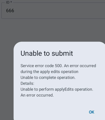

That trigger works using Field Map if I enter an ID that's never been entered before.
If the ID entered has existed in the record, then an error comes up :
Then, if I want to entry another data, *i have to repeat the process from the very beginning, with all empty coloumns*. I f I just change the ID into another unique ID, the same error message comes up just like the picture above.
So, how can I employ such a trigger.
FYI, this trigger works in Desktop without error.
Thanks

Hi @CodyPatterson ,
The only restriction is that it has to be unique. This ID is based on another layer underneath it (the ID of the layer underneath is already unique) and the data have to be entered manually. I have to run this mechanism of entering it manually because I have to do so : the layer underneath is a polyline, whereas the one that I am working is a point layer. One of the points inside a polyline must have the ID of that polyline.
The trigger above somehow actually works in Field Map not in a way it is intended. If I enter an ID that is already existed and filled in all other text boxes (there are around 12 questionaires), press SUBMIT, and then that error (that error in the pic above) comes up. After the error, I just *can not simply change* the ID to another unique  value and then press SUBMIT again. The same error comes up.
But, if I do the entry from the beginning (with all 12 text boxes emptied out), and put in a unique ID, it will work without error. This is pains as I have to fill in all the text boxes again.
I have overcome this problem of re-entering-data-from-beginning by employing Attribute Validation, set in Arcgis Pro, below. But this method is rather process heavy because all data are copied into Datastore. If only a few records this method will work fine.

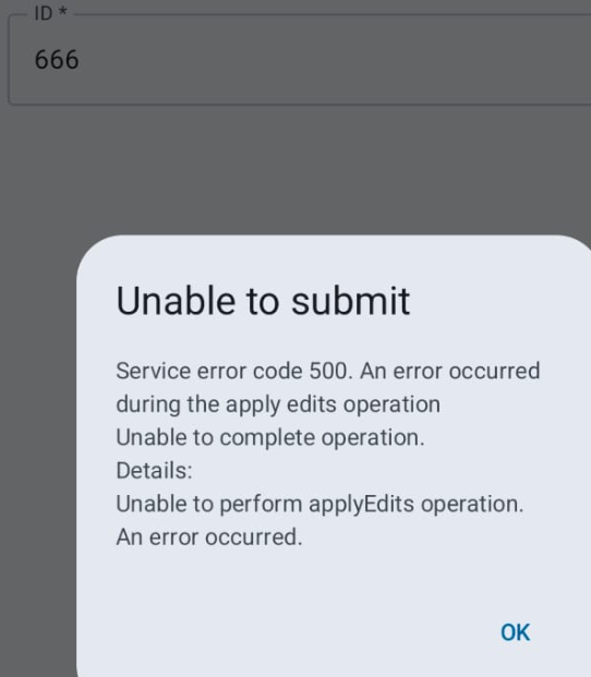

yockee
Hi @JeffSilberberg The code you provide gives out the same result.
Anyway, now I find out behaviour in Field Map this :
1. I enter duplicate value. press SUBMIT
2. Error comes up "Unable to submit. Service error code 500. bla bla"
3. Then without exiting, I edit the value again. Now type in a non-duplicate value. press SUBMIT again
4. Error comes up "Unable to submit. Service error code 500. bla bla"
5. Then I press SUBMIT again straight away. Success.
6. I check the database. The record is there with objectID x+3
What I want is, when I press SUBMIT for the second time (step #3), the record will be inserted without error.
The trigger itself is not a problem when executed using database query run from PGADMIN.
Thanks

yockee
@JeffSilberberg Yes..  shouldn't be "scema". I just want to show that the table reside in a schema. Thanks
Anyway, I did try the code you give me. Still the same behaviour on the Field Map, just like what I have described above.
The problem is not with the trigger, but how the Field Map reacts to the trigger.

yockee
I come to a conclusion that somehow the Field Map can not handle such error in a correct manner.
Allow me to summarize the trouble after a trigger is implemented:
1. First, entry an *incorrect* record (data that has already existed)
2. The response from the Field Map : "Error.."
3. Second, entry a *correct* data.
4. The response from the Field Map : "Error.."
5. Repeat step 3 by directly hitting the Save button
6. The response from the Field Map : "Success !"
So, for my case above, the second entry (step number 3), the Field Map still regard it as error. The subsequent entry (step number 5), is success. The trigger is not a problem.
It seems that the Field Map still regard the second entry (step number 3) incorrect due to the first entry (step number 1). Perhaps there is a cache that has not been cleared. Or maybe something else.
I can not confirm the exact cause.
