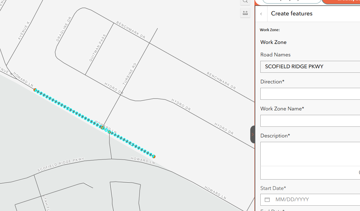

SNyquist
I'd like to use an Arcade Function to populate the Road Name for a Work Zone Layer based off an underlying Road layer. The issue that I'm running into is that the expression is pulling the name from an intersecting road and not from the main line that I'm digitizing along.
// Create a feature set using the 'All Roads' layer in the map
var roads = FeatureSetByName($map, 'All Roadways', ['MAP_LBL'])
// Intersect the current location with the road and
// get the first road
var road = First(Intersects($feature, roads))
// If the current location does intersect a feature,
// return the name of the road. Otherwise, return null
if (!IsEmpty(road)) {
return road['MAP_LBL']
} else {
return null
SNyquist
@ZachBodenner @gis_KIWI4
By using the assistance of Microsoft Copilot I was able to come up with a solution. I took your solutions and applied a Buffer function to find the largest overlap. Thanks!

SNyquist
Thanks, this is a great solution. But, I'm still having some issues. I'm wondering if it actually has to do with the accuracy of the snapping with the Experience Builder Editor Tool. Also, the fact that I'm trying to pull information from a large Feature Service, so there is some lagging. I'm going to try and clip out a smaller section of the road Feature Service and see if that helps with performance. Thanks for your help!
