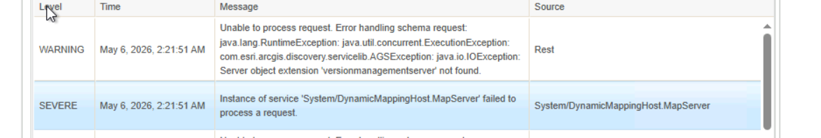

I am working ArcGIS field maps to for field survey and update feature information using ArcGIS field maps app. I am able to create and submit features using online. But when it comes to offline, I was failed to sync my updates. I am getting the below error in arcgis server log when I click sync offline edits in ArcGIS field maps app in my iphone/ipad.
I am getting this issue with both UN data and GN data.

Have you looked at the troubleshooting logs in Field Maps App?  That might give a better idea of what is going on.
I say that as the two errors in the log you posted seem to appear at least once or twice a day since AGS 10.6.1 (still in 10.8.1 and 10.9.1) and tech support finally gave up on trying to figure out why.  So, I kind of doubt it is related to the offline issue.
Never seems to cause any issues that we've noticed.  But, I have not tried offline with Portal, nor branch verioning.
