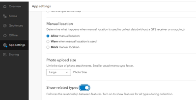

Might have to turn on collection settings for related types.
Profile icon --> Collection Settings --> Related Types --> Toggle "Show Related Types" to On
https://doc.arcgis.com/en/field-maps/android/use-maps/configure-field-maps.htm#ESRI_SECTION1_9422B85...
This can also be controlled at the map level in Field Maps Designer (which should default the behavior on the specific map.)
App Settings --> Collection --> Toggle "Show Related Types" to On

Yep I have that setting on.  Still doesn't show up.  I did happen to find a way to make it show up.  When the popup for the related table is shown, I can drag it towards the bottom of the screen as if to minimize it.  Once i am half way down the toolbar pops up.  Then i use a second finger to click the edit button.
MitchellGrafstein
Sounds/looks pretty buggy to me then.
