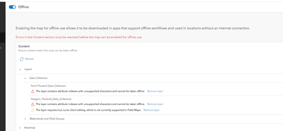

I have a field map project that has been used offline for over a year. Now I checked it and notice this error message. Can someone explain what it means and what I should do?

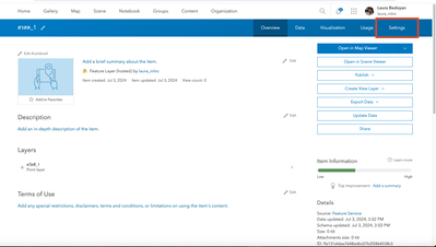

We created a new error message for this release to flag feature layers that have indexes with hyphens, causing SQLite replica failures; more details can be found here.

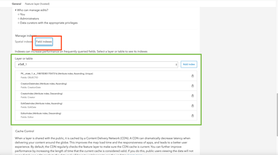

Could you please navigate to the settings pane of your layer.
Then, scroll down to the "Manage Indexes" section, and then click on "Field Indexes"?
After that, could you provide me with the details of your field indices? Everything in the green box like in the image above?

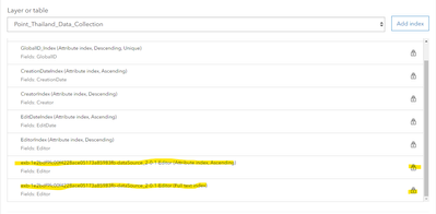

In addition to the post above, do you see any field index records that contain a hyphen for example (exb-<string>)
These are mostly likely causing the error and can be removed from the location pointed to above.

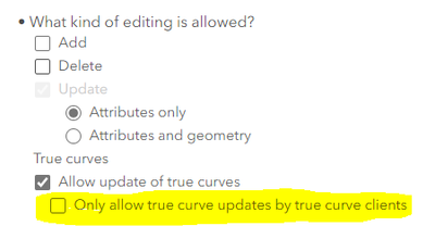

The other warning message above ensure that the following settings are selected in the settings of the appropriate layer and this should remove the amber warning

Hi. I am experiencing the same error message and I can see there are two field indexes in the format (exb-<string>) and despite clicking on the delete button and clicking ok it doesn't delete them. Any ideas how I can resolve this as it's preventing users taking maps offline with the problem layer in. I was able to delete field indexes before the update.
I have also tried using the Remove Attribute Index tool in ArcPro and this also failed and threw up this error; 'ERROR 160203: Failed to load a resource (string, icon, bitmap, etc)
Failed to execute (RemoveIndex)'.

  • Open the layer in arcgis pro > right click to get properties> Indexes > in the table, select the index that has the hyphen > delete > click apply > okay.
    • Open the properties again and check. Repeat (sometimes you have to repeat the steps a few times before it finally registers)

Thank you for responding! It does look like I have some hyphens in my indexs.
Thank you for the settings recommendation above. It fixed the yellow error about true curve updates!

I have removed all the indexes that have a hyphen, except two that are locked.
Is there a way to unlock these two so that I can remove them? I think it is the same issue that @LouiseHarris1 is experiencing.
DanielFox1
@LayerItOn
When you saw these indexes locked is this before or after any new offline areas where created?
If you have existing areas can you sync them and remove them then try delete the indexes or temporarily remove the layer from the search widget in your experience builder and see if this unlocks them.
