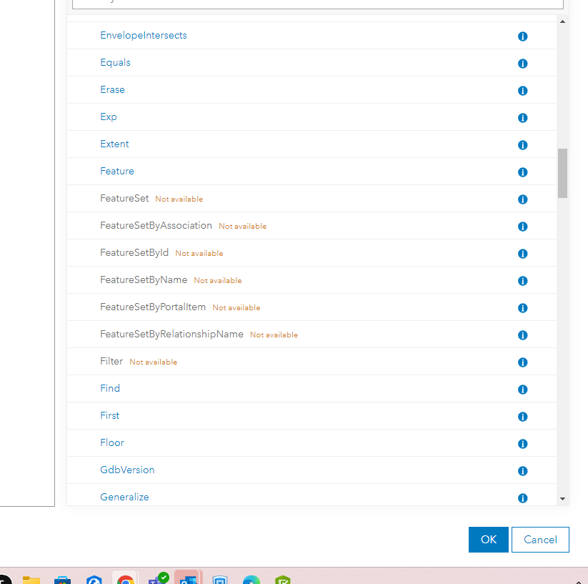

I am currently working on a project where I am designing a field map in Portal (10.9.1). The layer that I am trying to configure the form for was created from a Survey 123. There is a field in the form called "FSA" that I configured in the survey to be populated based on a polygon area, so the field will be filled out based on what FSA the point falls within. I am trying to do the same thing in the Field Map to have the FSA field auto-fill, but am running into issues. None of the FeatureSet functions are available, which I want to use to do the calculation, and the only expressions I can write are for conditional visibility.
Is there any way to do this calculation to populate the polygon name that contains the point within the FSA field?

Thank you for that suggestion! However, for some reason in Field maps, the FeatureSet functions are unavailable, so these calculations will not work. Would you know why certain functions are unavailable or another way around that? Thank you so much!

Sorry to hear it's not working! I have noticed some pretty significant differences in Arcade functionality between ArcGIS online (AGOL) versus older versions of Enterprise. If you have the ability to reference your Enterprise data in Map Viewer via AGOL and test your Arcade expressions there, that could be helpful.
