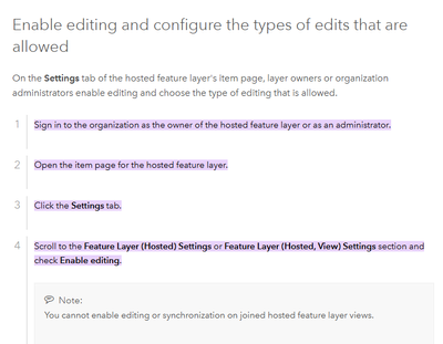

EmilyGeo
Hi @JCasebolt
are you the owner of the layer?
The layer owner or an administrator must change the settings for the hosted feature layer itself (not the view) to enable editing. See this help page for more details.

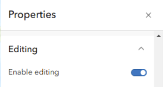

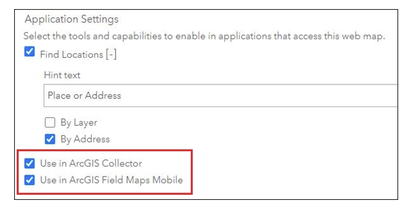

EmilyGeo
Hi @JCasebolt
To make sure the Web map is editable in Field maps, there are some settings you can verify:
1. Ensure the 'Use in ArcGIS Field Maps' checkbox and Use in ArcGIS Collector options are ticked in the Application settings.
2. Make sure that the layers are set to be editable in the web map
JCasebolt
Hi @EmilyGeo
Yep, all those things are checked. What is interesting is that the duplicated web map has Use in ArcGIS Collector and Use in ArcGIS Fieldmaps Mobile as an option to check/uncheck whereas the original 'read only' web map only has the Use in Field Maps as an option. Not sure if that is the problem. It doesn't make any sense to me that the duplicated map would have different settings available. It would be great to solve this so in the future I don't have to duplicate every map I create to make it editable.
