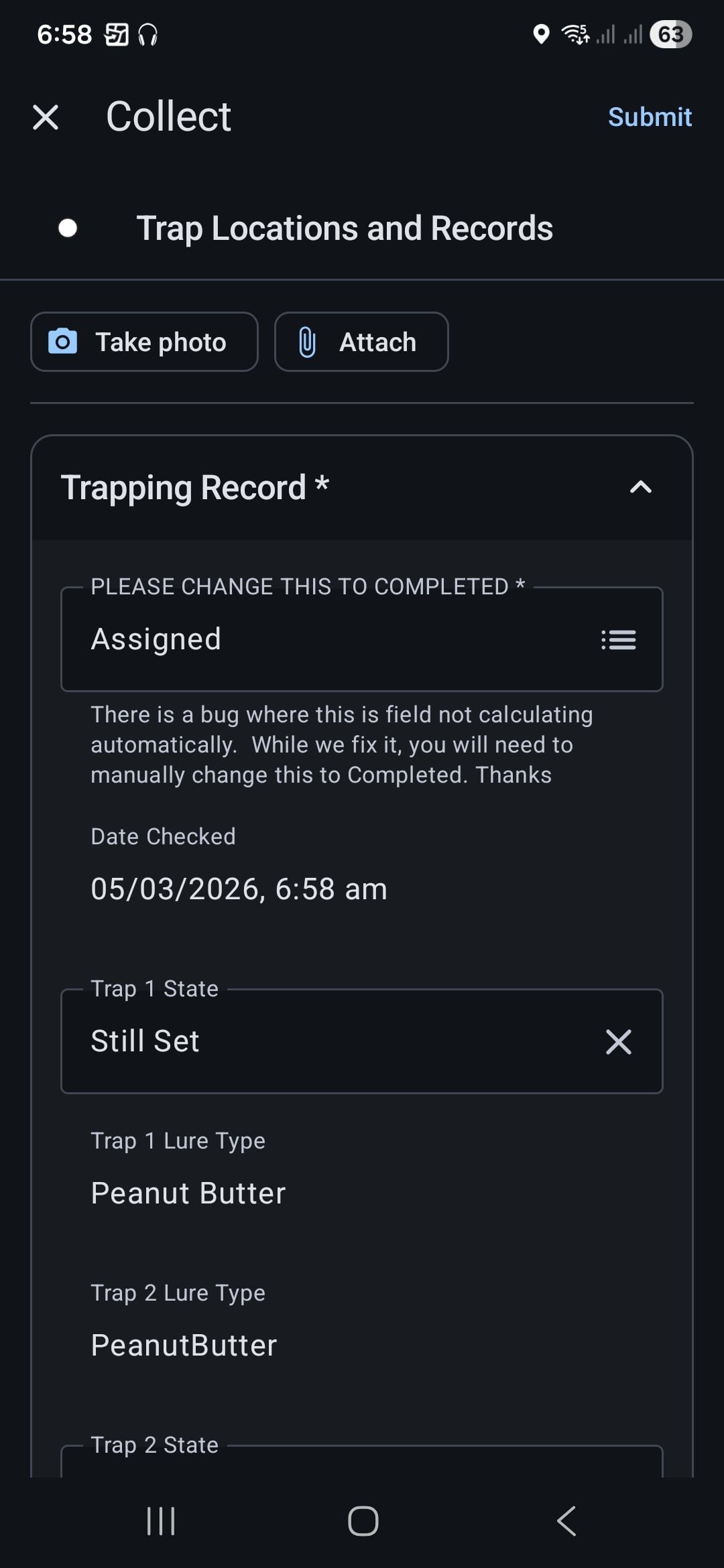

Anway, i need a new workaround.  This is all i have for the moment which is less than ideal.
Screenshot_20260305_065828_Field Maps.jpgScreenshot_20260305_065828_Field Maps.jpg
