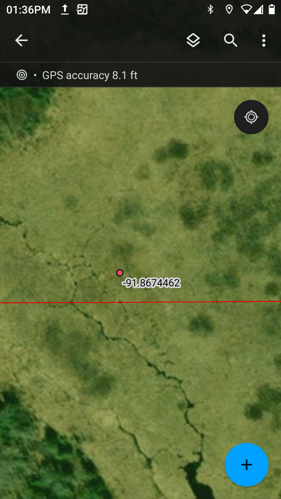

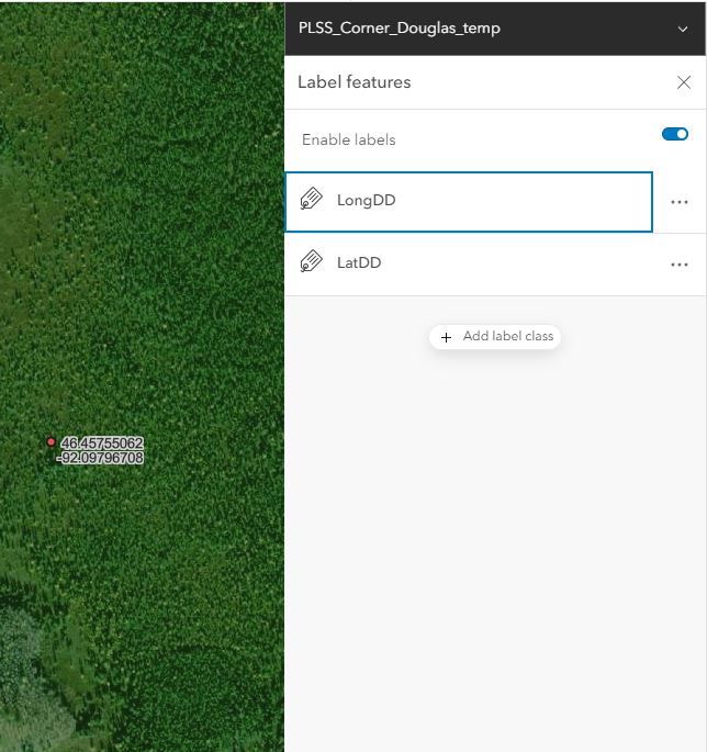

I have set 2 label classes in Map Viewer to display the latitude and longitude of a point feature. They display correctly in MV but when I open the map from Field Maps, only one label class appears. Any known solutions for this? Thanks!

I've experienced this as well. I got around it by using arcade to concatenate the two labels, but it was disappointing to not be able to use the convenient multi-class labels.
