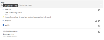

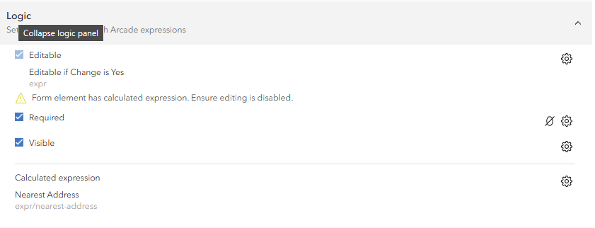

I created a form to pull the nearest address using a calculated field and created a mechanism to add a custom address if wanted.  It works fine in the Web Map, but in field maps, the address never shows up.
Code for Editable Flag:
DomainName($feature, "IsAddressEdit") == "Yes"
Code for Calculated Expression:
var searchDist = 100;
    var addresses = Intersects(FeatureSetByName($map, "City Parcels"), Buffer( $feature, searchDist, "feet"));
    var cnt = Count(addresses)

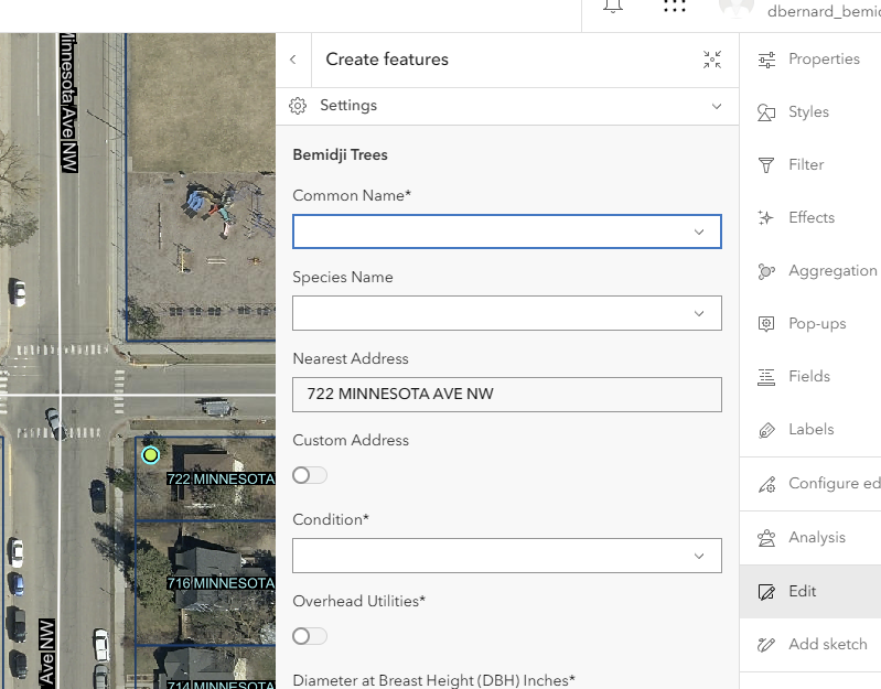

Works fine in Web Map:
Doesn't work in Field Maps.
DerekBernard
I did not have my "Custom Address" switch visible in the Pop-up screen (because I did not really want it there.)  When I added it into the Pop-up, it started working.  It was always available in the edit screen, but making it available in pop-up is what worked.
