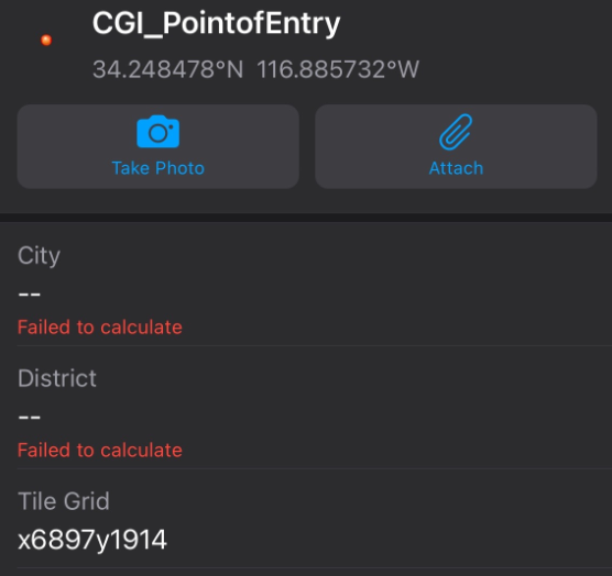

However, upon testing this expression in field maps it appears to fail to calculate the expression:
I am unsure what the issue is precisely, I have similar expressions built for Tile Grid which works but it seems to be having issues with Cities and even Districts. Has anyone come across this issue?

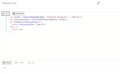

I do not, everything seems kosher in the expression builder window:
