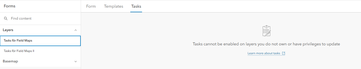

Hi, I am trying out the new tasks functionality in Field Maps. I want to use a EGDB layer published as a Referenced Feature Layer as my task layer. I get this message:

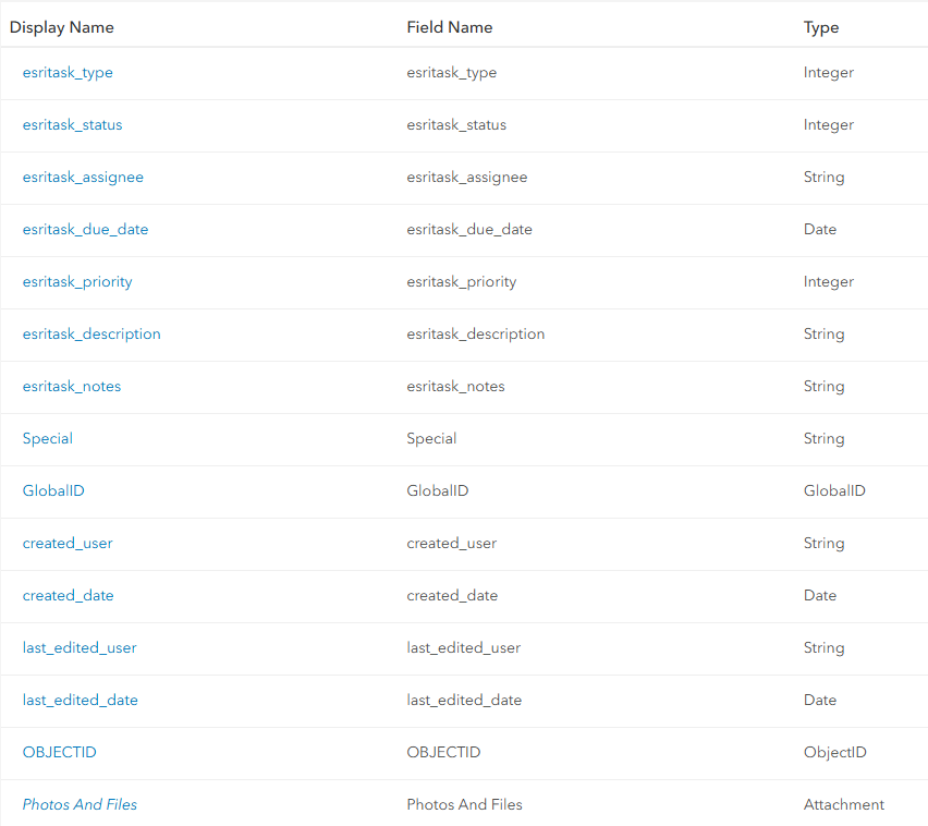

I am the owner of the layer and it has editing enabled. I have manually created the fields that are needed:

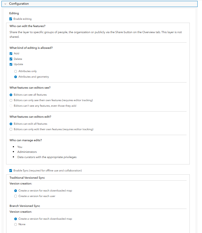

I have enabled sync:
Is there something that I am missing?

Hello @AndreasHall - It appears your Due Date field is incorrectly entered. The field name should be esritask_duedate (duedate being one word). You entered esritask_due_date (with the underscore).
Please try deleting the field and re-adding it, and let us know if that works.
