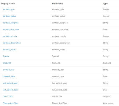

I am the owner of the layer and it has editing enabled. I have manually created the fields that are needed:

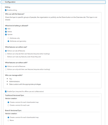

I have enabled sync:

Hello @AndreasHall - It appears your Due Date field is incorrectly entered. The field name should be esritask_duedate (duedate being one word). You entered esritask_due_date (with the underscore).
Please try deleting the field and re-adding it, and let us know if that works.

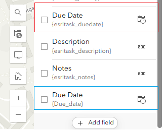

Thank you very much for your clear explanation. What I meant to ask is what happens if a user sets the field alias (display name) as “Due date” and the field name as “Due_date” before creating any tasks in ArcGIS Field Maps as shown below:
PiyaliKundu2
Based on your screenshot, nothing would happen. Your screenshot shows that you already have the field esritask_duedate in the schema which is the field we are looking for in order to enable tasks.
After enabling tasks, you can use your other Due_date field if you'd like instead. Just make sure to reference that field in the Form and task configuration as you build your layouts and actions. The esritask_duedate field is only required to enable tasks in Field Maps Designer. You don't need to keep it in order for tasks to be used in Field Maps mobile - so you can use your other Due_date field instead after tasks has been enabled.
