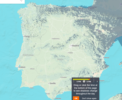

My previous company did something similar, but we used this map here: https://shademap.app/@40.13774,-4.04011,7.6701z,1767717458444t,0b,0p,0m
It lets you see a decent idea of where the shade will be at that time, we sent the link out in a social media post, and had people enter their addresses and then find the time like that, this is a screenshot:
