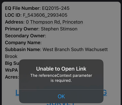

If I use the callback URL without the referenceContext parameter included, the callback seems to work, but does display an on-screen error when returning to Field Maps; this happens with either of the formats below:
https://survey123.arcgis.app/?itemID=10242016ba5b4ab3883bf40bb8ae76fb&field:Ag_Guid={GlobalID }&callback=https://fieldmaps.arcgis.app ://?itemID=6b34dffb1c0b41b3907c61a97d0b1e4a
https://survey123.arcgis.app/?itemID=10242016ba5b4ab3883bf40bb8ae76fb&field:Ag_Guid={GlobalID }&callback=https://fieldmaps.arcgis.app /?itemID=6b34dffb1c0b41b3907c61a97d0b1e4a
Error:
I did check and the Survey123 data submits properly. I am returned to the proper map in Field Maps, but see this error each time.
Does anyone have advice on how to resolve this issue?

erica_poisson
@Anonymous User -
This is the encoded URL I am using - Survey123 launches from Field Maps just fine, but the callback doesn't  happen. I submit the Survey and am returned to the Survey123 home instead of Field Maps.
Any advice would be useful.
arcgis-survey123://?portalUrl=https://www.arcgis.com&itemID=10242016ba5b4ab3883bf40bb8ae76fb&field:Ag_Guid={GlobalID}&callback=https%3A%2F%2Ffieldmaps.arcgis.app%20%2F%3FreferenceContext%3Dopen%26itemID%3D6b34dffb1c0b41b3907c61a97d0b1e4a
