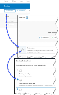

With the February 2025 release of ArcGIS Online, when you add a new item—Feature Layer that is based on an existing feature layer, the layer definition (symbols, labels, forms, etc.) will be included in the new feature layer. You will have the entire schema of the source feature layer including layer definition with no features in the new layer.

Update:   This is working in the latest online release.  Using the steps above, you can use any feature layer as a template for a new feature layer, retaining the layer definition (popup, forms, symbols, and more) in the newly created feature layer.

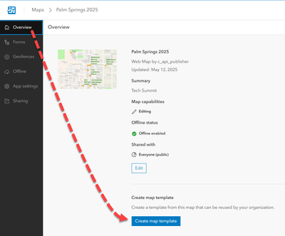

Also, with Field Maps Designer you can create a map template from an existing map.

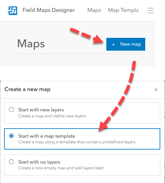

Then create a new map using the template.
