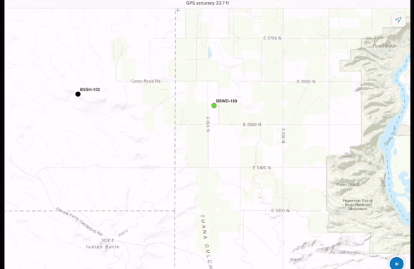

Yes I have like 30 of them using for 5 years now.  Here is a gif I have form a demo.  Sorry not sure the confusion this is pretty much SOP for a lot of folks.
This is going from Field Maps to 123 but its the same concept.  This one here you can launch 10 different forms and each one sends diff info.
URL here is  arcgis-survey123://?itemID=6df2d78c25914668a7ad59d4cb090832&field:LOCAL_ID={LOCAL_ID}&field:FormID={FormID}&field:ADMIN_ST={AdminState}&callback=https://fieldmaps.arcgis.app

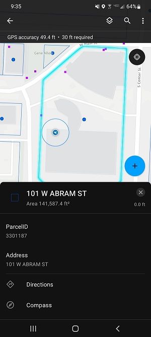

Absolutely no pressure to keep going with this conversation, but just to clarify the desired starting point for copying attributes is the user clicks on a parcel boundary (polygon) to indicate which feature they want to use for transferring the many field values we need in the new GPS point.
Polygon attributes -> GPS point using "Copy attributes" isn't possible out of the box in Field Maps.
I'm not following when you say "you'd have the popup of the point...". The goal is to not be clicking on a parcel centroid point like I have it now. I'd like them to click on parcel boundary polygons and exclude the centroid points layer entirely. They will clutter the map, since I have a separate meter point layer that will be used as well. Our field staff likely prefers to click on polygons instead of finding the appropriate point in the center. The problem is that the point to be collected by GPS isn't always inside the polygon.

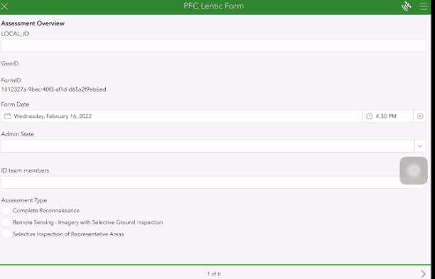

This one is 123 to Field Maps.
this URL is
<a href="https://fieldmaps.arcgis.app?itemID=bd19bf20c2c6430b8530940cb22dc21a&referenceContext=addFeature&fea...">Add a Point to Field Maps</a>
