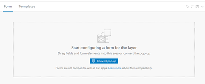

Yes, you will need to configure a form using Field Maps Designer.  If not, the form will be basic functionality (question/ answer) based on the field order defined in your schema.  The logic that handles contingent values is derived from the Field Maps form.
You can start by allowing Fields Map Designer to auto-populate the form configuration by selecting Convert Popup.  That may be enough to get the CVs to work.
