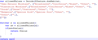

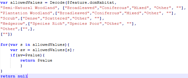

Having also used Sweet for ArcGIS for other applications, which does not honour contingent values, the method in there is to use a decode function in arcade to populate the allowed values using the script below, however when entering this into the calculated expression function in field maps form designer, its says that its invalid.
Is there a method of limiting domain values based on previous answers (ie contingent values/cascading selects) through arcade scripting in Field maps.
