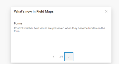

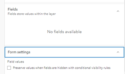

JustinReynolds
They have added this functionality (at least to some degree) in AGOL.
Unselect any group or field and scroll to form settings at the bottom right corner.  It is an all or nothing form level setting.
