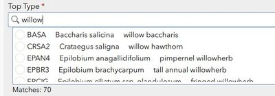

Survey123 is going to be the better choice for this.  It can handle the lists that size much better.  We have 12 state lists that are all around 60,000 and can flip between then with ease.  We set our label as Code  Common name  Scientific name (all 3) so that the user can use type ahead and find any of those.
 If you still want the spatial side use Field Maps for that then launch 123 forms from those points.  That is what we do and it is slick.  123 if the best for forms and Field Maps is the best for spatial maps.
