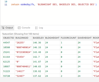

Evidently "DES" is totally fine with Arcade!

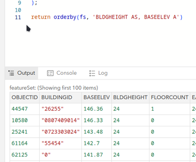

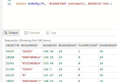

It gets weirder and funnier. Literally any text after the field name besides "ASC" is treated as "DESC". A typo on "DESC" is fine. But a typo on "ASC" will give you the opposite!

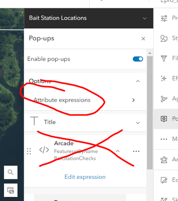

It works if I add it as an Attribute expression not as an Arcade element... maybe that was just a rookie mistake on my part. Why is that?

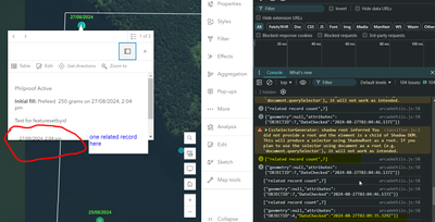

It doesn't show in the pop-up still though, and I've made sure I'm testing on a pop-up that has a bait station check.
I've had a look at the Developer Tools> Console. (Still new to this part, so tell me if I've missed something.)
It looks like it sees there are related records, and the dates for them.

When you made the arcade element expression, did you remove the pre-filled return portion? The return needs to be in that format for the arcade element version to work, you can't just have a simple return.
