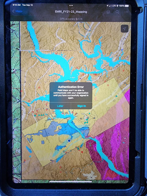

Hello,
I have been using Field Maps mobile for about 8 months now on my IOS devices. Every once in a while (2-3 weeks or so) the application will frequently prompt a user to sign in repeatedly, every 1-2 seconds. The sign in credentials are correct, and it works on our Samsung devices for the most part. Just wondering if anyone has a solution to this.
Thanks!

Aaron_Beutler
Hi, this is an issue that has recently popped up with our users also. We typically run three iPads in the field simultaneously and primarily collect offline.  Recently we've been in an area with cell signal and all three iPads all with different logins have been experiencing this error.  We have tried signing out and signing back in but the error message keeps coming back.  We have not tried uninstalling and reinstalling yet because it takes quite some time to sideload 200 gb of base map imagery.  Is there anything else that someone has found to be successful?
