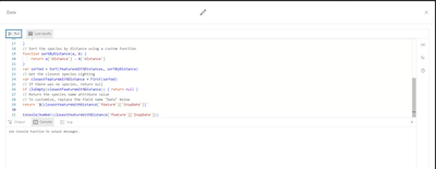

Your inspection date on the feature becomes 1700632800000. But that assumes milliseconds. Can you add this right before the end of your expression?
Console(Number(closestFeatureWithDistance['feature']['InspDate']))
What does the Console show?
If your feature is storing timestamps in seconds, but the other layer stores them in, say nanoseconds, that could account for the vast difference in displayed dates.

cat206
Hi Josh,
I've tried adding it in but it doesn't seem to be registering it which is really bizarre:
I must be going wrong somewhere but cannot figure it out
