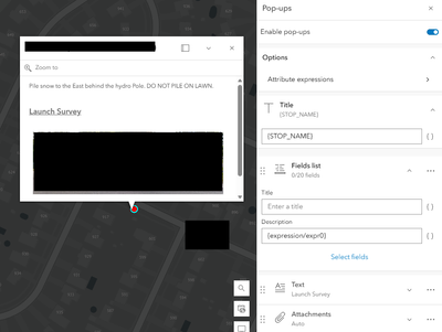

The arcade expression is stored in the pop-ups pane with the expression I mentioned above.
When I click on the point where the text should appear, nothing shows.

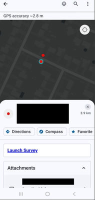

This is what it looks like in the field maps app
This is the error message:
Expression name:
Expression title: Note
Error domain: com.arcgismaps.exceptions.MappingException
Error code: 7018
Error description: Arcade expression is invalid. Expression doesn't return a dictionary.

the AI assistant came up with the following code which works in the map, but not in field maps.
IIf(
  $feature.stop_id == "00627",
  "Pile snow to the East behind the hydro Pole. DO NOT PILE ON LAWN.",
