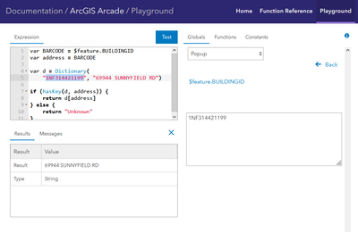

If I test it in the Playground, it works properly. Are you verifying the OldMeterNumber is returning the expected value?

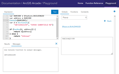

Make sure the test is giving you the correct Barcode with the Console function. It only reads the first record of your data.

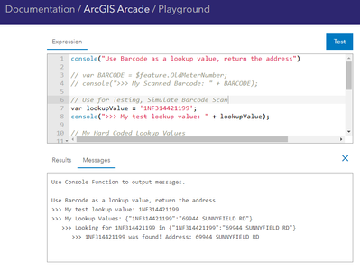

Can you provide a screenshot of what this arcade expression returns?

JD1016
Thank you so much for supplying the code.  That was so unexpected and nice!
I've attached what was returned.
I opened the ArcGIS Field Maps app and the address is auto-filled already in the Address field without even scanning the barcode.  Is that supposed to happen?
