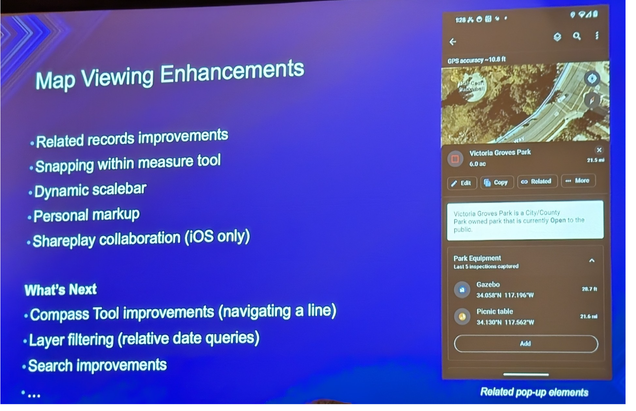

At Dev Summit they showed a whole new way to add related records that seems much better.  I think it is 1 click now.
Bad pic but you get the idea.  Not sure the exact time but I think next release.  May be worth checking that out.

That UI looks very handy. I hope it supports features with multiple relationships. 🤞
DougBrowning
MVP Esteemed Contributor
It was shown at UC also but not sure when its out?
ColinLawrence
This will be available with the 25.2 release of Field Maps later this year. We are currently targeting a fall release. Thanks!
