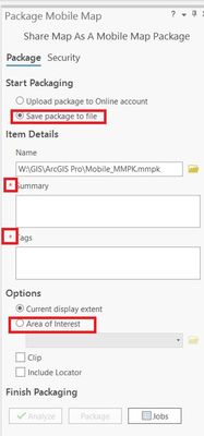

Next click Share > Mobile Map:
Now fill out the tool parameters:
  • Ensure that you select ‘Save package to file’
  • Add Summary text and Tags
  • Select ‘Area of Interest’ and select the polygon for the survey area – to automatically clip all datasets to the relevant extent.
