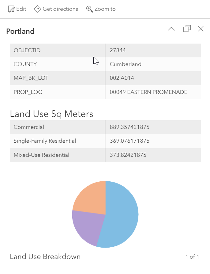

Pop-up using arcade for land use table and chart.Pop-up using arcade for land use table and chart.
As you can see from the pop-up, we have 3 land use types that fall within this parcel, and we can see the total sq meters for each of the 3 types. We also have a pie chart displaying the data below the fields. The code is the same as the code above, with the exception of the else and return statements. In this case, we are returning a pie chart instead of the fields as shown above.
