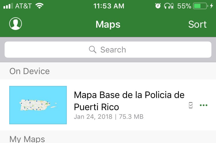

I create a mobile map package using ArcGIS Pro 2.1. I upload my MMPK file to my portal, I sign in to my portal using Explorer for ArcGIS 17.1.2 for IOS 11.2.5 . I download my mobile package to my device with no problem.

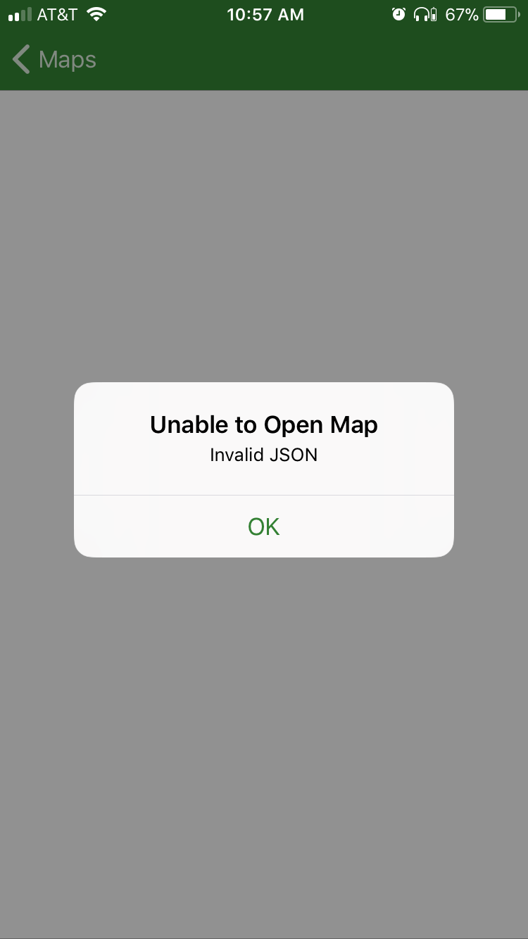

but when I try to open my mobile package in the app, i get an invalid json error.

For those that get invalid json errors, with a Mobile Map Package, it may have something to do with geodatabase domains that do not have any values.  Check to make sure your domains have values.

Here is another situation that will cause the "Unable to Open  Map invalid JSON' error.
If you have a Vector Tile Package layer in your Pro project.  (Ex. Add a .vtpk file to your map)
Make sure the VTPK layer name in the Contents pane does not have any spaces in it.
When the VTPK layer has spaces in its name, the space is written into the Mobile Map Package data structure, and that causes the JSON error when Explorer tries to load the map.
