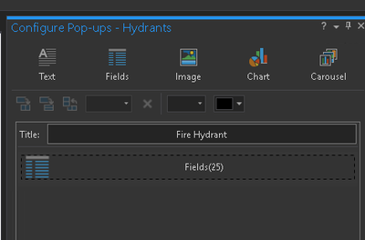

Hi, Not sure if I'm missing something obvious but I hope so.
Clicking on a layer in the map produces a popup window with the relevant attributes, but it does not specify the name of the layer anywhere I can see.
Is this just a field maps desktop app thing or is there perhaps some extra config needed to the ArcGIS Pro-produced MMPK?
Again, desktop not mobile.
Thanks.
RhettZufelt
MVP Notable Contributor
I manually set the Title field in the popup config to the layer name so it shows.
R_
RhettZufelt
R_
DavidPike
A gentleman and a scholar, many thanks.
