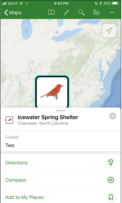

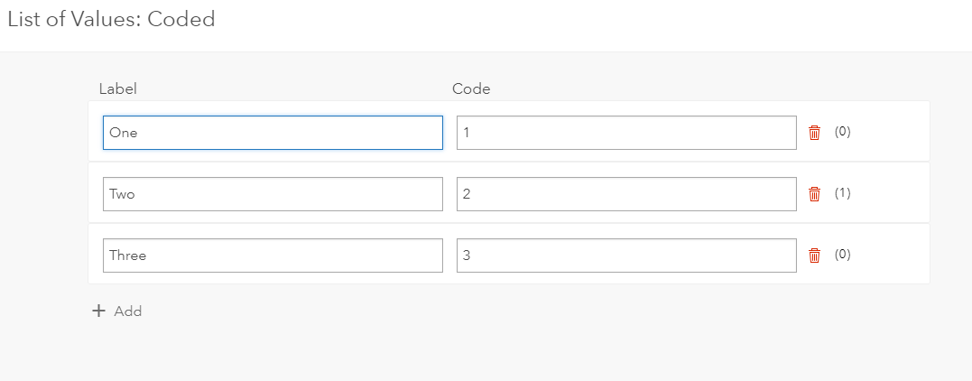

Terry,
Can you share a bit on how you set up your subtype and domain with codes used?
I did a simple test with Integer field 1, 2, 3   one, two, three.  and Explorer is showing the Label.
