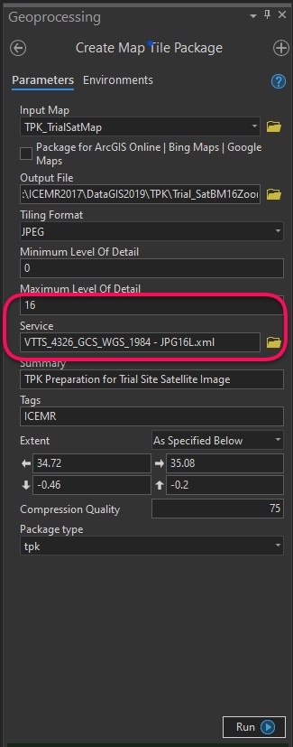

If I create Map Tile Package for a high-resolution satellite image inside the ArcGIS Pro, it only allows me to see the image in between Minimum and Maximum level of detail.  However, in order to reduce the file size for offline use on tablets, we only can create it at some maximum level around 16.  But we also want to let field staff can see whatever image as background even they zoom the map beyond the Maximum level of details because it would be better than nothing.
After reading this 2014 blog post https://community.esri.com/people/palavido/blog/2014/07/18/creating-a-tile-cache-or-package-that-is-...Scales, I realized there are two ways to do that:

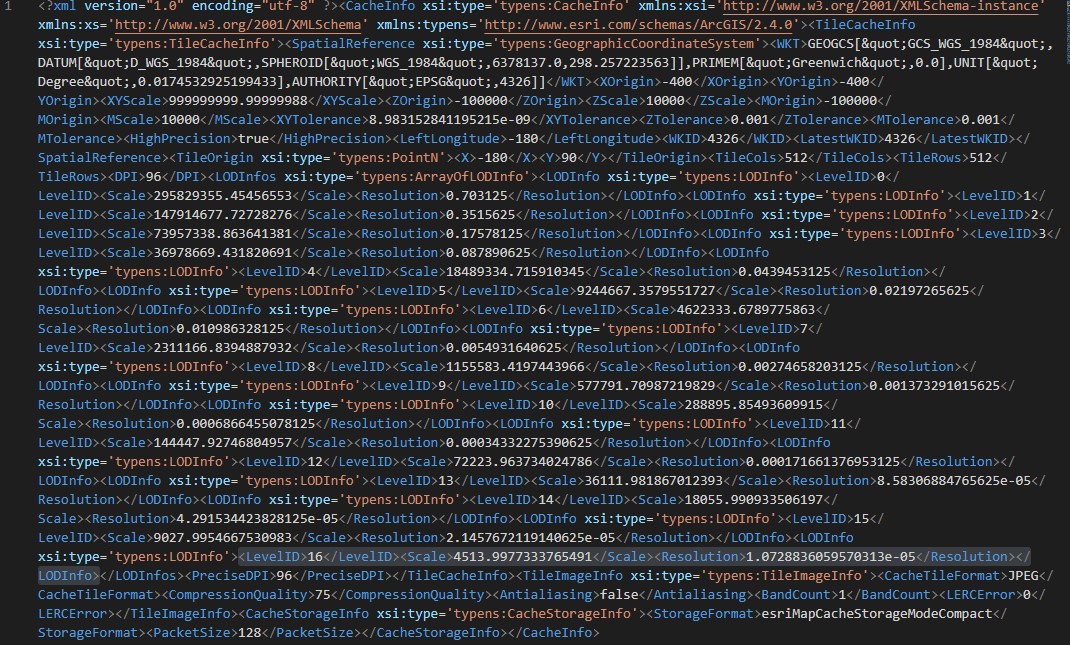

1. Unzipped  .tpk file, edit the  "conf.xml" under the "v101" folder.  Instead of changing the scale value for the lower level, we just delete those un-necessary levels.  For example, if you only create your tile package at a maximum level of 16, you just delete the other lower levels.  Save the edit file and replace the original one in .tpk (see below image).
Editing conf.xml
2. The other way is when you create a map tile package, prepare your service file only have the level you need, for example, level 16.  I attached a service file example for jpg at level 16.
