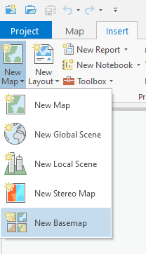

Insert a new basemap

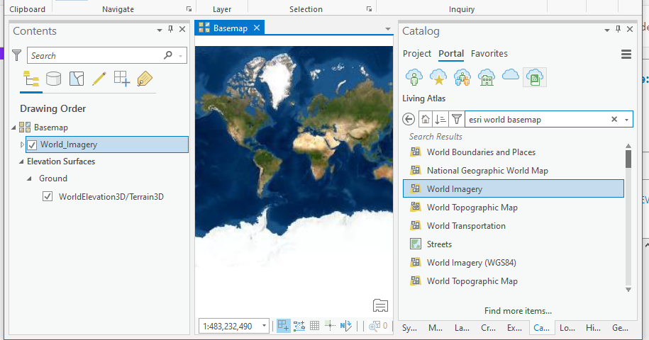

Then add the Basemap layers of your choice to this basemap.  Search Online and add...

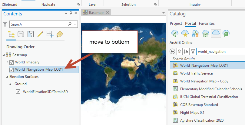

Then add another file based layer that will be packaged into the map.  I would suggest using a Vector Tile Package.  I created this one https://www.arcgis.com/home/item.html?id=07b04d145b86410eaf5c5c42a78d8e95  its Level of Detail 1 - just background.
Make sure it is the bottom layer in the map.

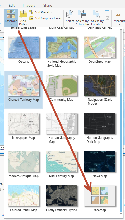

Then use this as the Basemap for your Map.
