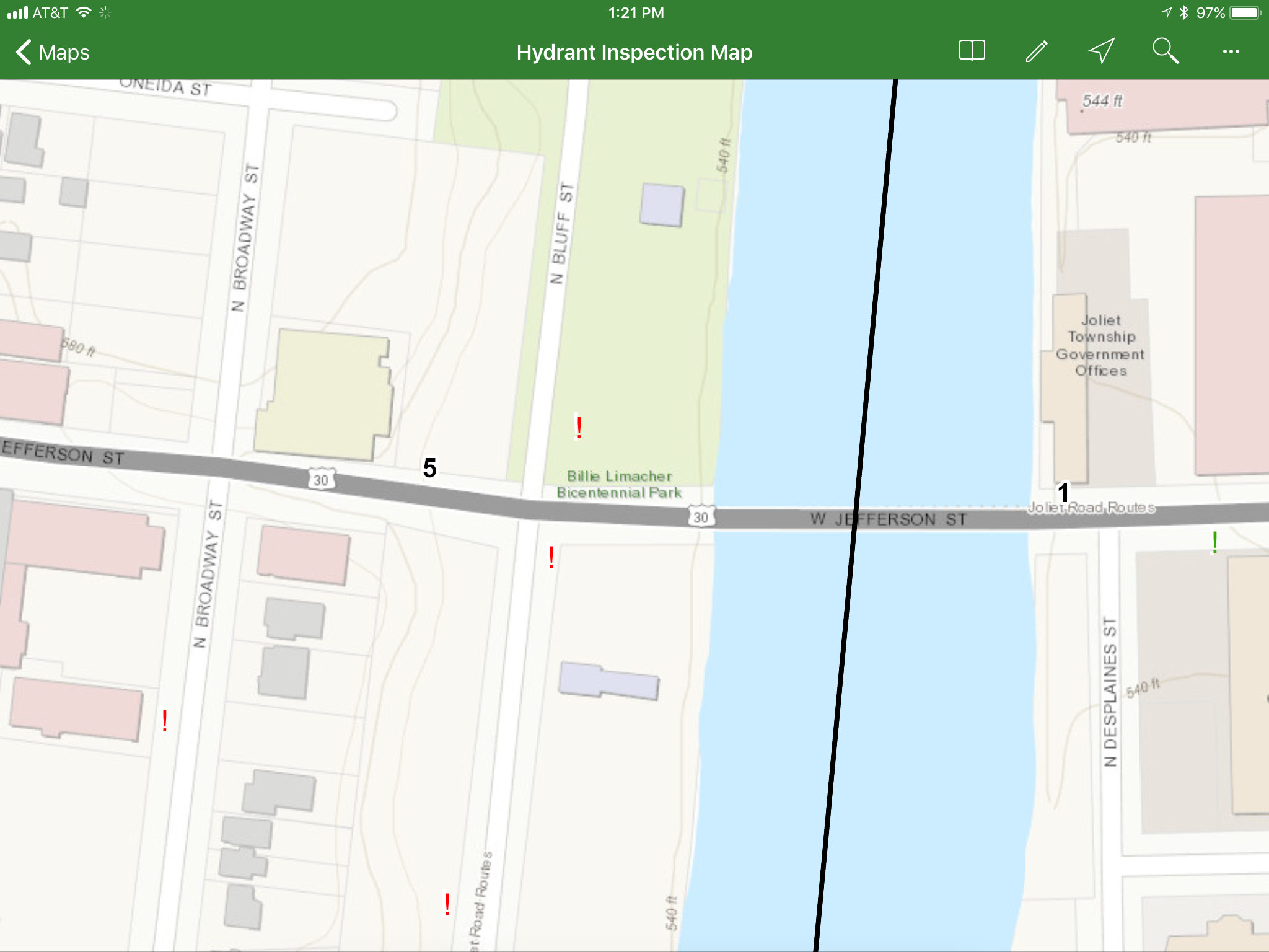

We are also experiencing issues with symbology showing up as ! instead of points (worked in old version and every other version and app) in layers that are not cached.

A couple of items to follow up on here, but I'll start with the Symbology you are seeing with the !. I haven't heard this issue yet.
- Are you able to take a screen shot of what the symbol looks like in AGOL, and what it looks like in explorer.
- It would be great to know what the symbol is exactly.  Is the symbology set in the service layer? or did you specify a different symbol when authoring the map? It may be something specific to the symbol being used, that will help me get to the bottom of this issue.

  I sent screen shots to support and our Partner contact last week showing the issue.  Below are 2 of the images we sent to them. The first shows how the symbology looked in Explorer iOS version 10.2.9 the second shows how it looks in 17.1.0.   It also looks fine in collector (app this is mostly used in) and the android version.  We have another map that uses very similar symbology that is not impacted.  One difference is that we have a second service layer that we use for the labeling with no symbology for the point.  The ! symbol is shown at all zoom levels.  The farther out zoom levels are only single color points (character marker), zoomed in (shown below) are 2 layerd points (one color and one background slightly larger white).
iOS Explorer 10.2.9 Hydrant Inspection AppiOS Explorer 17.1.0 Hydrant Inspection App
