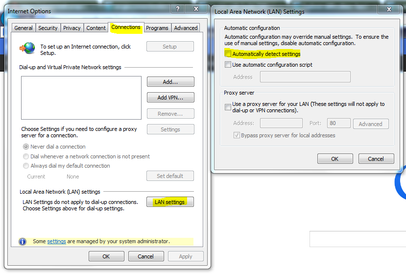

If your issues seem to be related to ArcGISConnectionBin.exe repeatedly crashing and restarting, you may have some luck unchecking the "Automatically detect settings" option under "LAN Settings" in the "Connections" tab of your Internet Options (accessed via IE):

The 4 machines in question use no proxy, just a basic internet connections but unchecking that did fix the repeated crashing / reloading. Thank you

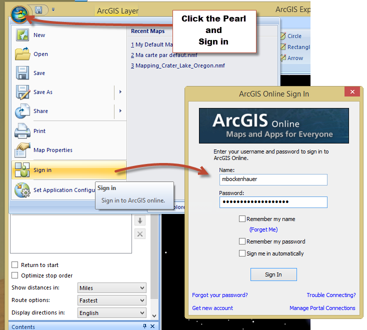

For the Second problem,  ArcGIS Explorer Desktop no longer showing Base Maps, Layers in the galleries or a default map when clicking new map.
this was due to an update to ArcGIS online, that changed how content is presented to users based on region. When not signed in IP Address is used to determine region.  To work around this there are a couple things that you can do.  One is to create your own base maps, as you have done.  All ArcGIS Explorer Desktop maps, default map and basemaps are available online and can be found here
http://www.arcgis.com/home/search.html?q=owner:esri_arcgisexplorer
Another workaround is to Create an ArcGIS online account or use one that you have.
https://www.arcgis.com/home/signin.html    A public account will work fine for this workaround.
Sign in and then edit your your user profile (or set it when you create your account).
  Set your Region to World
Then when using ArcGIS Explorer, Sign in using your ArcGIS online account.
When you are signed in and your User Profile Region is set to "World"  ArcGIS Explorer Desktop will show the base maps.  Other non-USA regions may also show base maps, which would explain variations in how Explorer users experience this "missing base maps" issue.
