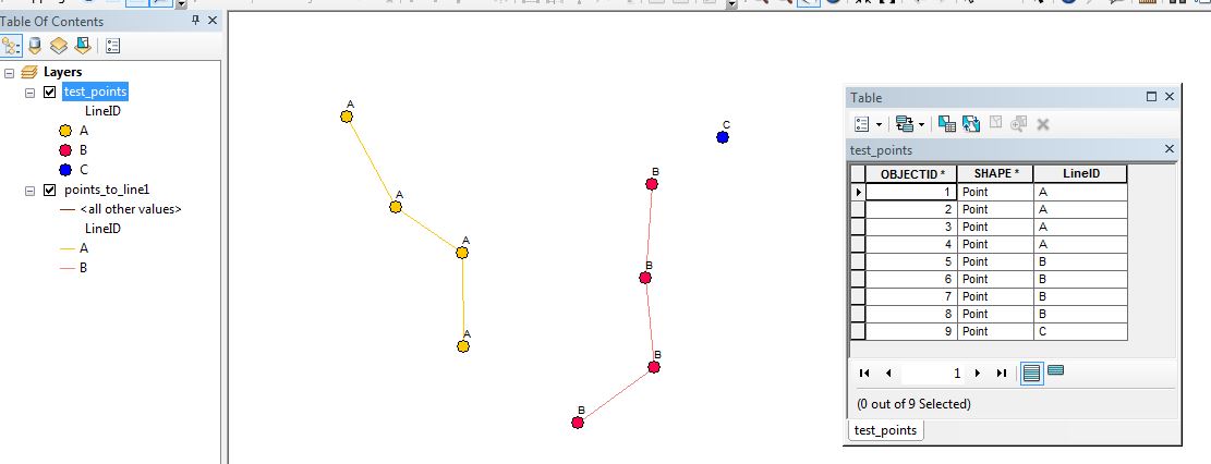

Can you elaborate what you mean by "in the middle of the points"?  More specifically, do you need the constructed line to break at an existing point, or at a position between points?
  • If it is the former, you may want to look into populating your points with an attribute you can then use as your "Line Field" when running Points to Line.  For example, all the points that make up the first line can be given a value of 1, all the points for the second line a value of 2.  Note - if the new lines should touch, you will need to duplicate any point at the junction where lines start/end so they get created and give it the appropriate line attribute.  Otherwise, there will be a gap as no line will be created (see image below where this was the case).

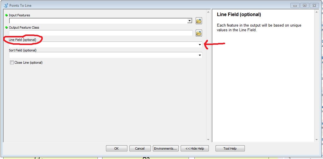

ChrisSlinko1
The points represent a line. In the points file there are actually 2 sets of points that represent 2 different lines that should not be connected. When I use the points to line tool the 2 lines becomes connected when they should not be connected. Is there any way to get the Point to line tool to create one line then stop then start again for another line. I would like to be able to do this without a script or doing anything exta.
Thanks, Chris
ChrisDonohue__GISP
MVP Alum
The Points to Line (Data Management) tool will work for what you want if you can come up with a field in the point attribute table that distinguishes which point belongs to which line.  If there's not already a field that contains that differentiation, you can create a new field and populate it with two different values.  Then start Editing and then select all the points that need to become your first line.  Use Field Calculator to give them all the same value.  Then select all the points that will form your second line.  Use Field calculator to give them all the same value, which needs to be different than what you used for your first line.  For example, in the image I had posted in an earlier reply I created a "LineID" field and populated it with "A", "B", and "C".  Then run the Points to Line tool, being sure in the Line Field (optional) part to click on the pulldown arrow on the right and choose the field that you just added the differentiating values to.
