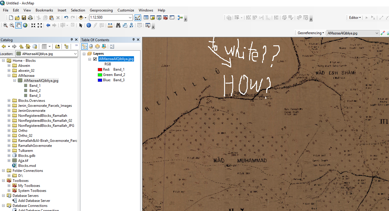

Hi All,
I couldn’t figure out how to change the background of a raster from brown to white?
Please note that I want to make this change in the raw image not for displaying purpose using symbology (I want to make it permanent)
You can find a sample data from here

The easiest way to do this is to simply resample the image file as a monochrome (Black and White) image.  You can do this in most image editors such as MS Paint or IrfanView.  Sample attached of your image.
