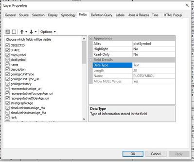

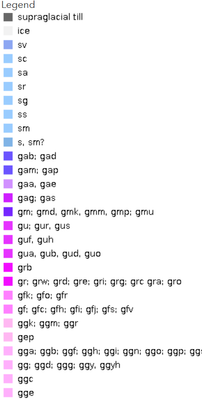

Hi, so basically I want my legend to display a different column from the attribute table than it is currently displaying. As per screenshots, it is currently displaying the values for mapSymbol or plotSymbol and I want this to be changed to name.
For context I am using a downloaded NZ geology map called QMAPs that came with predefined symbology that I assume is tied to plotSymbol. I don't know if this means that plot symbol is then made the default display for the legend or if it is mapSymbol as it is the first unique column in the attribute table.
Thanks in advance,
Ed 🙂
P.S I know my legend is all over the show in the photo but it is due to my playing around in frustration, I know I can make it double column etc.

Your legend is going to be based on the symbology settings for the layer. Based on your screenshot, it looks like it's coming from either the mapSymbol or plotSymbol fields, but I don't see a difference in the values.
